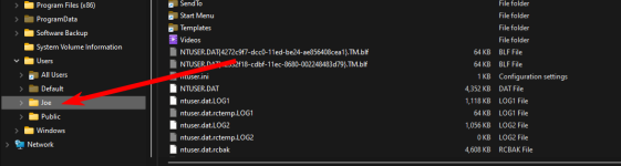

In my case before knowing this technique, I failed to create Local Account whereby the username was pretty ugly since my email is (e-mail address removed), it creates <C:\Users\xploi> no thats not I wanted, so referring to the above as I explained, firstly I logged on using the name Joe and successfully done, then proceeded with Microsoft Account whereby the username stays as <Joe>.
This is very usable to create a Local Account and let specific users to use their own online account and the Local Account name remains as they wish.
