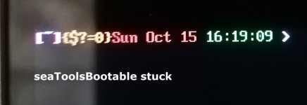

I made a SeaToolsBootable USB to test the SSD drive, it failed to boot properly and got stuck in the process of loading.

As for the USB not booting, could be the Secure Boot or Fast Boot in the BIOS is getting in the way. I see it happening with Linux LiveDVD booting on a Windows machine. Could be the difference between MBR, GPT and UEFI settings.
