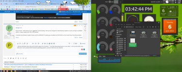

I ditched Windows when Microsoft ended support for Windows 7. My Daily Operating System Is Linux Mint. I can do more with Linux Mint than I ever could do with Windows Operating Systems, and do it with less cost involved. And Look at this picture, this is something no Windows OS can do
