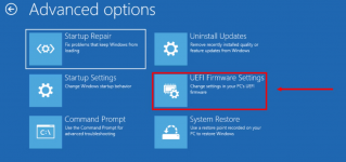

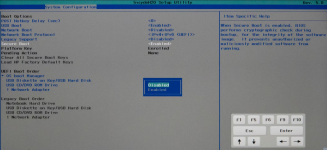

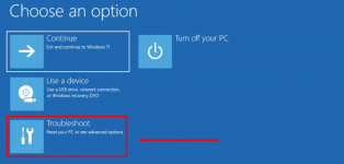

1. Open the Start menu and open the power menu in the bottom right corner. Then, hold Shift on your keyboard and click Restart. You'll be taken to a blue screen that looks somewhat like this;

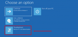

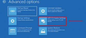

2. Here, choose Troubleshoot, followed by Advanced options.
3. Select UEFI Firmware Settings.
4. This will take you to your PC's BIOS settings, where you can turn off Secure Boot. Every BIOS is a little different, so you may have to look around. In the HP laptop we're using here, you can navigate to the System Configuration tab at the top and you'll find the Secure Boot option. It's set to Enabled by default, and you want to change it to Disabled.
5. Save the changes and restart the computer to follow the rest of the process. If you ever stop using Linux, you can enable Secure Boot again by following the same steps in reverse order. Save all changes, and restart the computer.

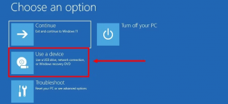

2. You'll be given a series of boot options. Click Use a device, then choose the USB flash drive you have inserted and your PC will boot from it.

2. Click Troubleshoot and then Advanced options.

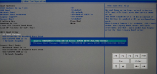

4. You may need to press one of the function keys to open the BIOS setup. Once you're there, the process will vary depending on what PC you have. We're looking for options related to booting. On the HP laptop we're using here, you can find Boot options in the System Configuration tab.
5. Find an option related to boot order (UEFI Boot Order, in our example) and make sure the Linux drive is on top of the Windows drive.
6. In our example, we have to select the OS Boot Manager option, then use the F5/F6 keys to move Ubuntu to the top. Again, the process may vary by laptop, but the same principle should apply to any device.
If you're on a desktop, you may need to navigate to the Advanced Settings and switch the Boot Order inside your motherboard BIOS.

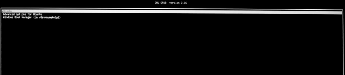

7. Exit and save the changes. After a restart, you should see the Linux boot menu, which lets you continue into your Linux distribution or boot into Windows. You'll see this menu every time you restart your computer so you can always choose your preferred boot option.

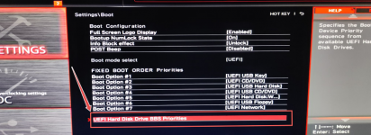

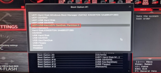

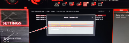

However, if your PC shows the Windows Boot Manager and doesn't display the option to boot into Ubuntu, you may need to modify the Hard Drive BBS Priorities in the BIOS. To do so,
1. Head back to your motherboard's BIOS and navigate to the Boot settings.
2. Click on the BBS (BIOS Boot Specification) option.
On most MSI motherboards, this setting is called UEFI Hard Disk Drive BBS Priorities. But it can have a slightly different name depending on your motherboard manufacturer.
3. Set Ubuntu as Boot Option #1.
You can also use this setting to switch back to Windows 11.​
