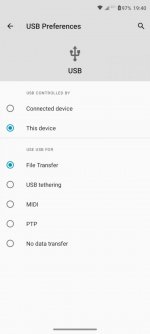

On android you have to tell your phone that you want to transfer files. Go into Settings and look for {USB Preferences} then check (File Transfer) but leave the option [USB controlled by] on [this device].
After that it will show up in File explorer in Windows right under "My PC"
