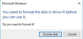

Hello, I have encountered an unpleasant event. My external hard drive has stopped working. The disc is no longer readable . When I connect the disc to my computer, the system asks me to format it.
There are very important files on the disc.

Test the enclosure with a known good drive. If you get the same message, then your enclosure bit the dust and your drive and data may still be good. I use SSD's for over 8 years know (Samsung's included) and so far all are still working.

I managed to recover most of the files.
I came across this video on YouTube.
Hetman Partition Recovery was able to recover 90% of the data from the disc. This is probably the best result so far. Overall, I'm satisfied because I managed to recover most of the data for little money. Thank you all for your help)
I have several external hard drives that came to me as junk, because they were in an enclosure that no longer worked.
The best one, was a Seagate 8TB HD (not an SSD). It almost took the jaws of life to get the drive out of that plastic enclosure, but it was worth the effort, because I now have it mounted permanently in my MAIN desktop PC, and I use it as a Storage/Backup drive.
Very few external HD's actually die, but the cheap enclosures that they are in certainly do.
So, if an external HD seems to fail, I'll just pull the drive out of the enclosure, and 90% of the time, the drive will be OK.

What @The Shadow 2023 does, I've recovered a number of drives. An issue with the External USB drives is the case contains a printed circuit board/interface and probably is running a lite version of Linux, particularly those that can work with 2 or more different operating systems. The format of the drive itself may not be known and Windows can't work with as many formats as Linux can.
